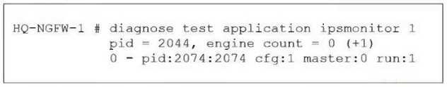

As an administrator you have created an IPS profile, but it is not performing as expected. While
testing you got the output as shown in the exhibit.
What could be the possible reason of the diagnose output shown in the exhibit?
  • A. There is a no firewall policy configured with an IPS security profile.
  • B. FortiGate entered into IPS fail open state.
  • C. Administrator entered the command diagnose test application ipsmonitor 5.
  • D. Administrator entered the command diagnose test application ipsmonitor 99.
The output shows the IPS engine count as 0, indicating no active IPS engines are running. This
typically means no firewall policy is referencing the IPS security profile, so the IPS profile is not being
applied or triggered.

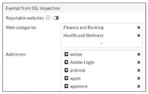

The predefined deep-inspection and custom-deep-inspection profiles exclude some web categories
from SSL inspection, as shown in the exhibit.
For which two reasons are these web categories exempted? (Choose two.)
  • A. The FortiGate temporary certificate denies the browser’s access to websites that use HTTP Strict Transport Security.
  • B. These websites are in an allowlist of reputable domain names maintained by FortiGuard.
  • C. The resources utilization is optimized because these websites are in the trusted domain list on FortiGate.
  • D. The legal regulation aims to prioritize user privacy and protect sensitive information for these websites.
FortiGate's temporary SSL certificate may cause access denial to sites using HTTP Strict Transport
Security (HSTS), so such sites are exempted from deep SSL inspection.
Legal regulations require exemption of certain categories to protect user privacy and sensitive
information, so these web categories are excluded from SSL inspection.

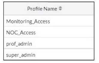

The NOC team connects to the FortiGate GUI with the NOC_Access admin profile. They request that
their GUI sessions do not disconnect too early during inactivity.
What must the administrator configure to answer this specific request from the NOC team?
  • A. Move NOC_Access to the top of the list to ensure all profile settings take effect.
  • B. Increase the offline value of the Override Idle Timeout parameter in the NOC_Access admin profile.
  • C. Ensure that all NOC_Access users are assigned the super_admin role to guarantee access
  • D. Increase the admintimeout value under config system accprofile NOC_Access.
The admintimeout setting in the admin access profile controls the inactivity timeout for GUI sessions.
Increasing this value will extend the session duration before automatic disconnection.

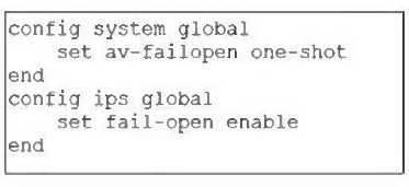

Based on this partial configuration, what are the two possible outcomes when FortiGate enters
conserve mode? (Choose two.)
  • A. Administrators cannot change the configuration.
  • B. FortiGate skips quarantine actions.
  • C. Administrators must restart FortiGate to allow new session.
  • D. FortiGate drops new sessions requiring inspection.
In fail-open mode, FortiGate skips quarantine actions to maintain traffic flow despite IPS or antivirus
failures.
FortiGate drops new sessions that require inspection when in conserve mode and fail-open is
enabled, to protect the network from potentially harmful traffic.

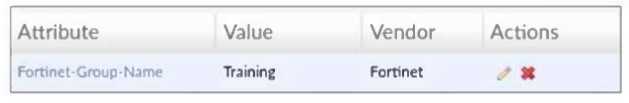

Refer to the exhibit, which shows a partial configuration from the remote authentication server.
Why does the FortiGate administrator need this configuration?
  • A. To set up a RADIUS server Secret.
  • B. To authenticate Any FortiGate user groups.
  • C. To authenticate and match the Training OU on the RADIUS server.
  • D. To authenticate only the Training user group.
The Fortinet-Group-Name attribute is used to restrict authentication to users who belong specifically
to the "Training" user group on the RADIUS server.

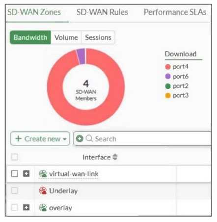

Refer to the exhibit, which shows an SD-WAN zone configuration on the FortiGate GUI.
Based on the exhibit, which statement is true?
  • A. The Underlay zone is the zone by default.
  • B. The Underlay zone contains no member.
  • C. port2 and port3 are not assigned to a zone.
  • D. The virtual-wan-link and overlay zones can be deleted.
The Underlay zone is the default SD-WAN zone, typically representing the physical interfaces in the
SD-WAN configuration before overlay or virtual links are added.

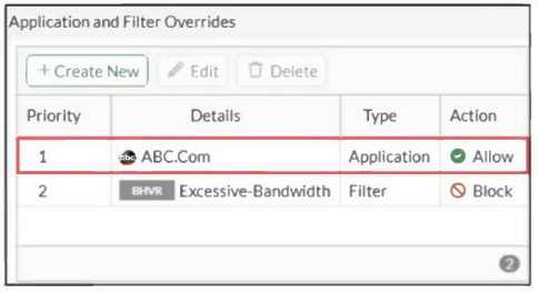

An administrator has configured an Application Overrides for the ABC.Com application signature and
set the Action to Allow. This application control profile is then applied to a firewall policy that is
scanning all outbound traffic. Logging is enabled in the firewall policy. To test the configuration, the
administrator accessed the ABC.Com web site several times.
Why are there no logs generated under security logs for ABC.Com?
  • A. The ABC.Com Type is set as Application instead of Filter.
  • B. The ABC.Com is configured under application profile, which must be configured as a web filter profile.
  • C. The ABC.Com Action is set to Allow.
  • D. The ABC.Com is hitting the category Excessive-Bandwidth.
When the action is set to Allow in an application override, traffic matching this override is allowed
without generating security logs because it bypasses deeper inspection and blocking.
