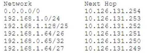

Review the exhibit.
Given the routing table shown in the exhibit, what is the next-hop to reach the host 192.168.1.129?
  • A. 10.126.131.251
  • B. 10.126.131.252
  • C. 10.126.131.250
  • D. 10.126.131.248
The next-hop to reach the host 192.168.1.129 is 10.126.131.250. This can be determined by looking
at the routing table in the exhibit. The host 192.168.1.129 falls within the range of the network
192.168.1.64/26, which has a next-hop of 10.126.131.250. Reference:
Ericsson IP Networking - IP
Addressing
Software Installation and Upgrade Overview (Junos OS)
