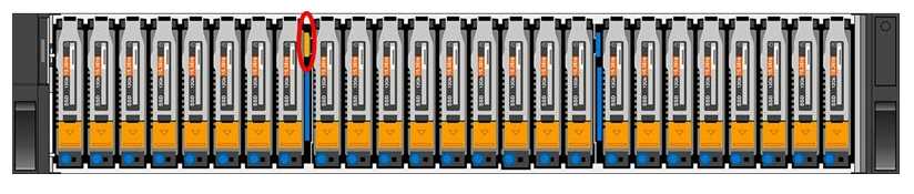

What is indicated when the circled LED on an expansion enclosure is illuminated amber?
  • A. Expansion enclosure power-on
  • B. Expansion enclosure faulted
  • C. SAS bus link down
  • D. SAS bus link up
The illuminated amber LED on an expansion enclosure typically indicates a fault. In the context of
Dell PowerStore expansion enclosures, an amber light can signify various issues such as power
supply problems, cooling system malfunctions, or other operational faults that may affect the
enclosure’s performance.
When troubleshooting, the following steps are generally taken:
Identify the specific LED that is illuminated amber using the hardware documentation.
Consult the Dell PowerStore Hardware Guide to determine the exact nature of the fault indicated by
