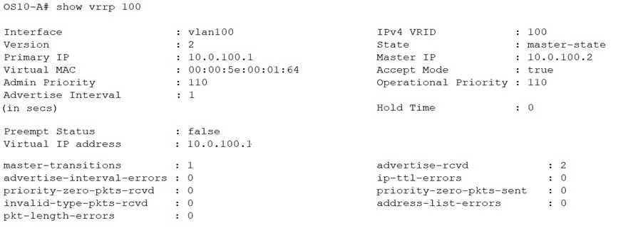

What is the VRRP state of OS10-A after a router with a default VRRP admin priority with VRID100
comes online?
  • A. master-state
  • B. standby-state
  • C. backup-state
  • D. primary-state

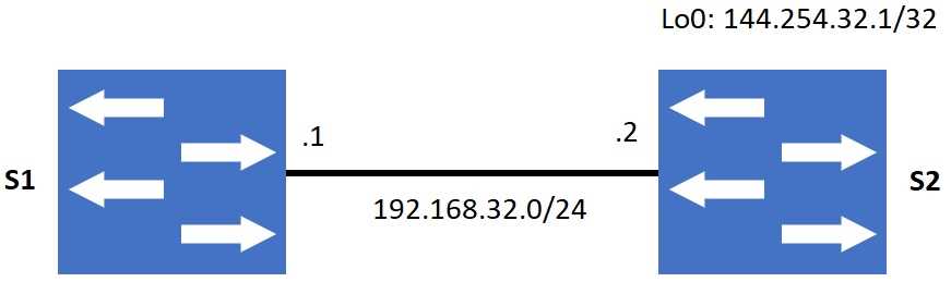

Which configuration will allow S1 to ping S2’s Lo0 address?
  • A. S1(config-router)# ip route 144.254.32.1 192.168.32.2/32
  • B. S1(config-router)# ip route 192.168.32.2 144.254.32.1/32
  • C. S1(config)# ip route 144.254.32.1/32 192.168.32.2
  • D. S1(config)# ip route 192.168.32.2 144.254.32.1/32
