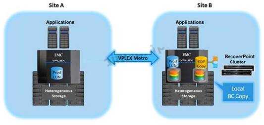

A storage administrator wants to protect their distributed VPLEX volumes using RecoverPoint and the
VPLEX splitter. The admin asks if there are special considerations they must be aware of.
What should you tell the admin?
  • A. The VPLEX Consistency Group that is protected by RecoverPoint must have its site preference set to Site B.
  • B. RecoverPoint does not support replication of distributed VPLEX devices.
  • C. Only VPLEX devices at Site B can be replicated using RecoverPoint.
  • D. All VPLEX devices at both sites can be protected using RecoverPoint, regardless of whether they are local or distributed.

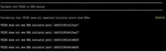

A RecoverPoint cluster with two RPAs and VPLEX splitter has been deployed. When you run the rp
validate-configuration VPLEX CLI command, the error shown in the exhibit is displayed.
What is the most likely cause of this error?
  • A. Only two initiators per RPA have been used.
  • B. The RPAs are not zoned to the VPLEX BE ports.
  • C. One of the two RPAs is missing.
  • D. The RPAs are not zoned to the VPLEX FE ports.

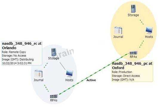

In Unisphere for RecoverPoint, the status tab diagram of a particular Consistency Group shows two
copies linked by a dashed green line on top of a solid green line. What type of link is this?
  • A. Synchronous
  • B. Asynchronous
  • C. Fibre Channel
  • D. iSCSI

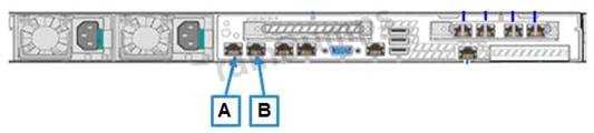

A customer is implementing a RecoverPoint solution with a two-node cluster. What is represented by
the 'A' in the exhibit?
  • A. WAN
  • B. LAN
  • C. iSCSI
  • D. Floating IP
