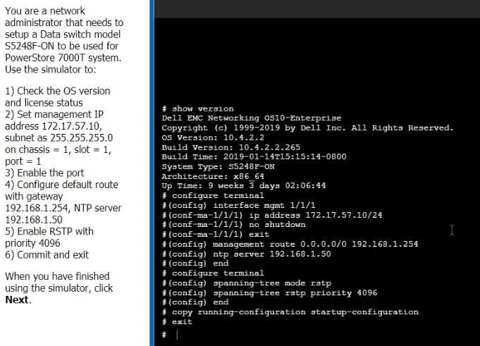

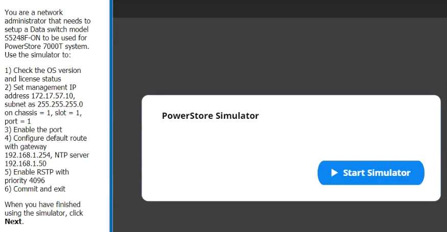

You are a network administrator that needs to setup a Data switch model S5248F-ON to be used for
PowerStore 7000T system Use the Simulator to:
1) Check the OS version and license status.
2) Set management IP address 172.17.57.10 subnet as 255.255.255.0 on chassis = 1, slot = 1, port =
3) Enable the port
4) Configure default route with gateway 192.168.1.254, NTP server 192.168.1.50
5) Enable RSTP with priority 4096
6) Commit and exit.
A. Explanation:
Below are the exhibits solution for this simulation.

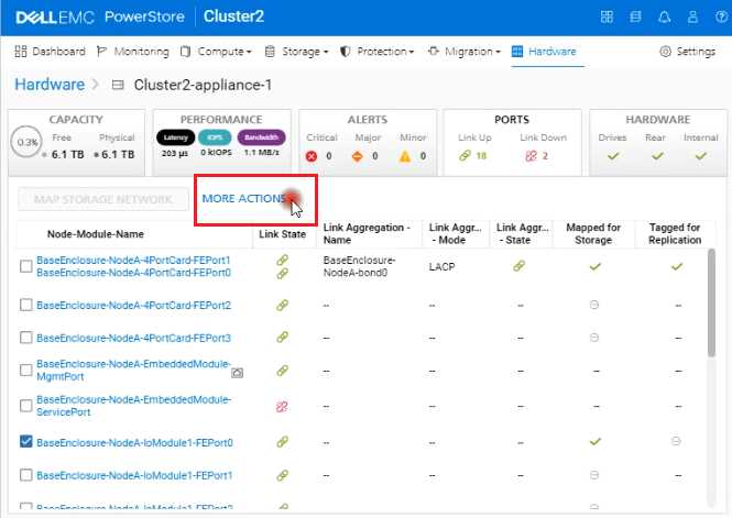

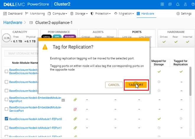

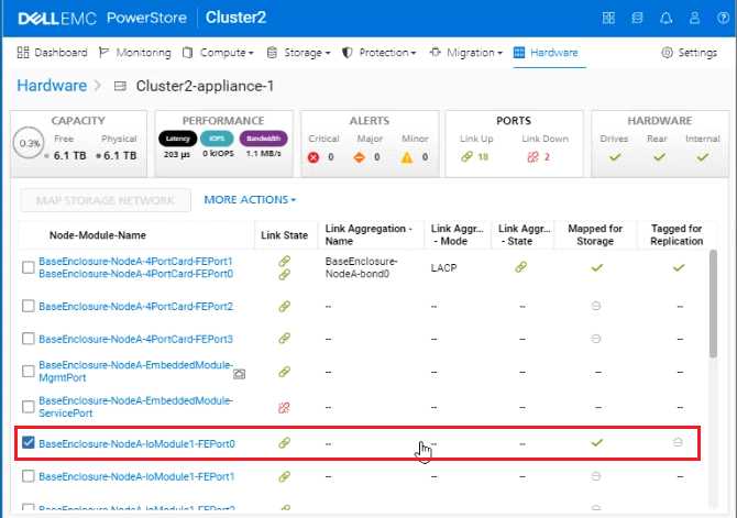

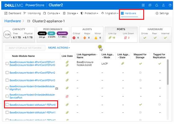

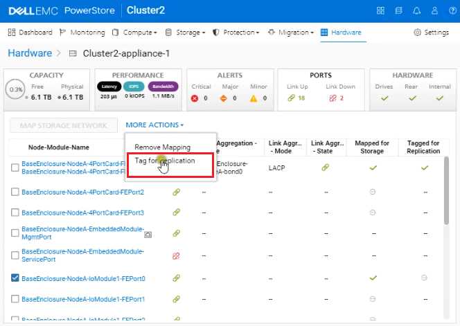

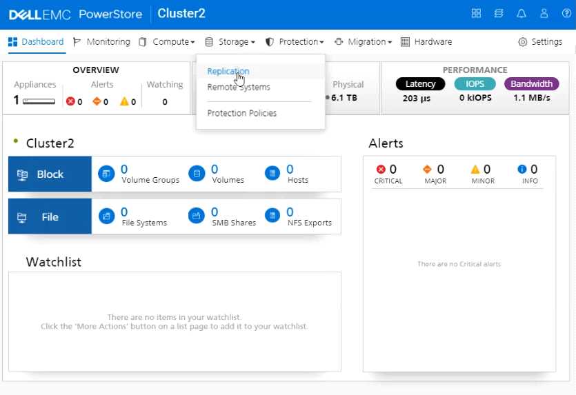

Use the PowerStore Manager simulator to configure the BaseEnclosure-NodeA-IoModule1-FEport0
as a replication port. When you have finished using the simulator, Click Next.
A. Explanation:

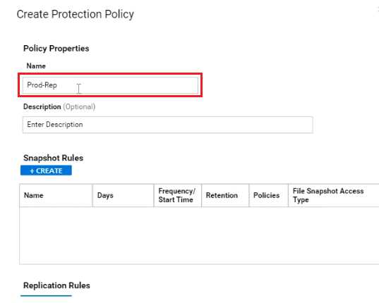

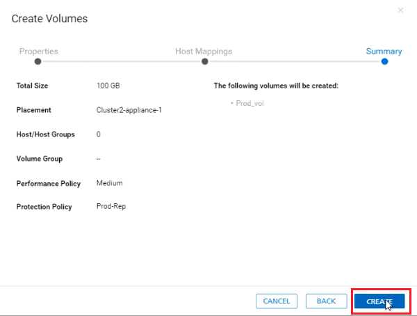

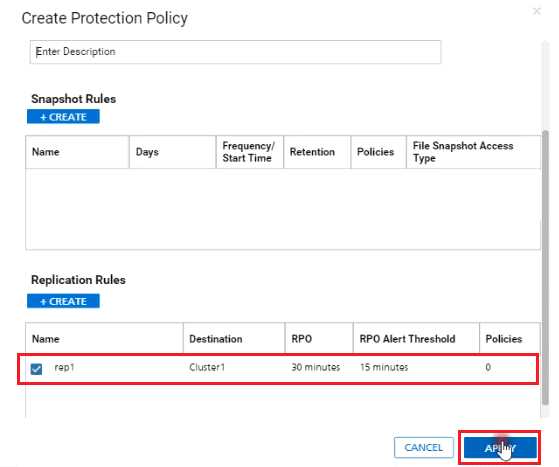

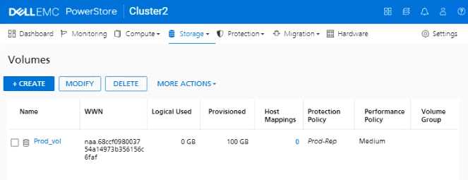

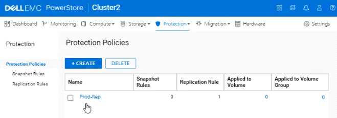

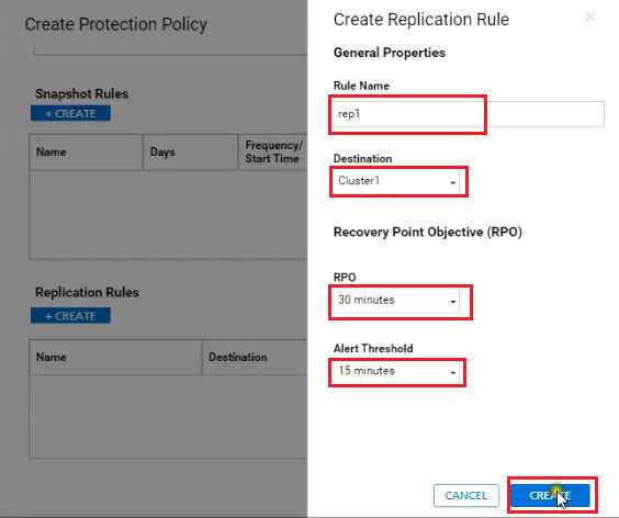

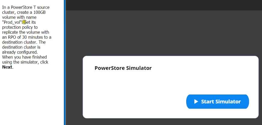

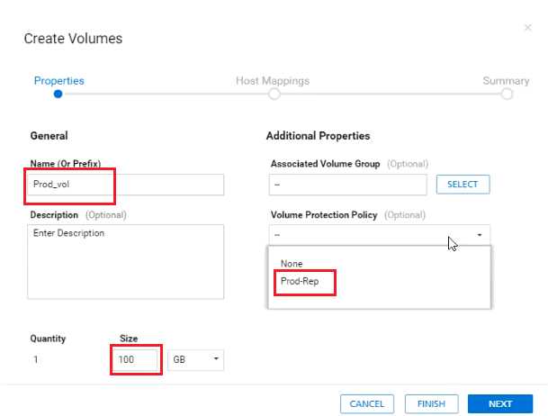

In a PowerStore T source cluster, create a 100GB volume with name "Prod_vol" and set a protection
policy to replicate the volume with RPO 30 minutes to a destination cluster. The destination cluster is
already configured. When you have finished using the simulator, click Next.
check the
answer below in
explanation.

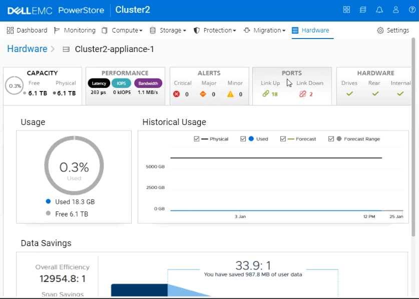

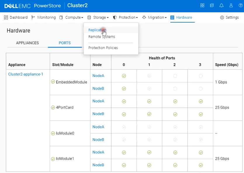

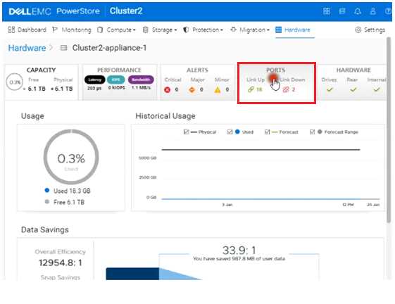

Use the simulator to determine how many logical ports are currently marked for replication on the
PowerStore appliance.
Note: It is necessary to close (x) the simulator window before you can select a response to this
question.
Simulator:
  • A. 1
  • B. 2
  • C. 4
  • D. 6

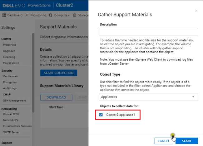

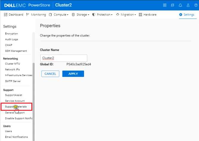

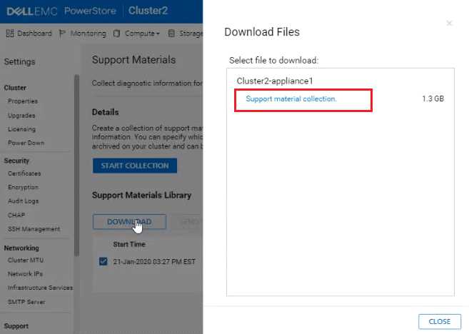

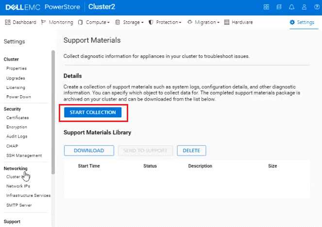

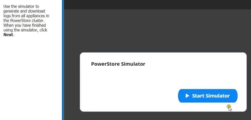

Use the simulator to generate and download logs from all appliances in the PowerStore cluster.
check the
answer below in
explanation.

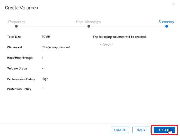

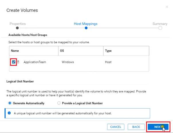

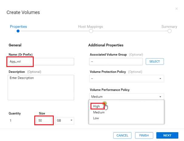

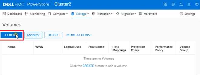

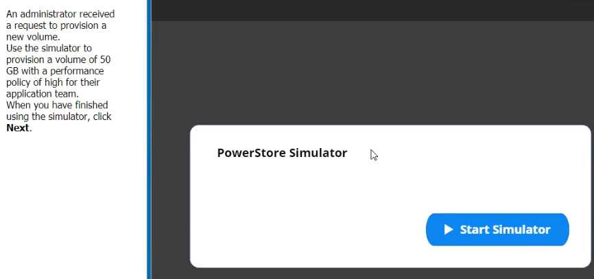

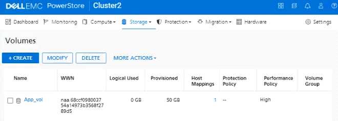

An administrator received a request to provision a new volume. Use the simulator to provision a
volume of 50 GB with a performance policy of high for their host named "ApplicationTeam". When
check the
answer below in
explanation.

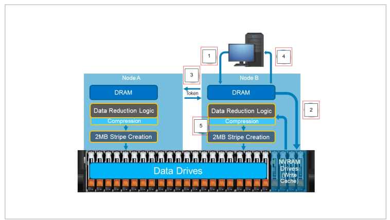

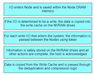

Correctly arrange the sequence of the write operation in PowerStore.
Write Operation
The graphic explains the process when the PowerStore receives a write request.
Step 1.
In this example, an I/O enters Node B and is saved within the Node
1. What type of I/O it is.
2. What resource it is intended for.
3. The location within the resource being updated or requested.
4. And other metadata information.
Step 2.
If the I/O is determined to be a write, the data is copied into the write cache on the NVRAM drives.
After the information is stored within the write cache, the information stored within the DRAM
memory is considered clean as it no longer has the latest copy of the information. This data then
becomes part of the read cache, until it is later replaced in cache by newer or more highly accessed
dat
a.
Step 3.
For each write I/O that enters the system, the information is passed
between the Nodes using tokens. This operation updates the peer node that a new write has been
received and that it has the newest copy of the data. A token includes information about the I/O such
as what resource was updated and the address within the resource that was updated. A token also
includes information Data Efficiency about the location the I/O was saved to within the write cache.
If the peer Node requests that information, the Node can access the data within the NVRAM drives
using its own internal channels.
Step 4.
After the information is safely stored on the nonvolatile media of the NVRAM drives and all other
actions are complete, the host is acknowledged.
Step 5.
After the host is acknowledged, data is copied from the Write Cache and is passed through the
deduplication and compression logic. The remaining data is then assembled into 2 MB stripes and
saved to the back-end storage.
