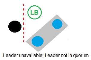

In which example will auto-failover occur?
