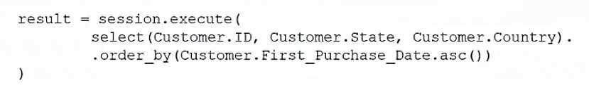

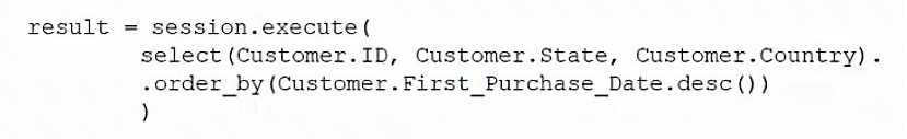

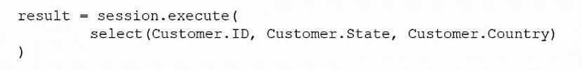

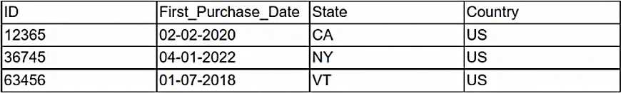

Given the following customer table:
Which of the following ORM snippets would return the ID, state, and country of all customers with
the newest customers appearing first?
The ORM snippet that would return the ID, state, and country of all customers with the newest
customers appearing first is option C. This snippet uses the select method to specify the columns to
be returned, the order method to sort the results by ID in descending order, and the all method to
fetch all the records. The other options either have syntax errors, use incorrect methods, or do not
sort the results correctly. Reference:

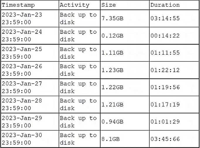

A DBA is reviewing the following logs to determine the current data backup plan for a primary data
server:
Which of the following best describes this backup plan?
  • A. Monthly full, daily differential
  • B. Daily differential
  • C. Daily full
  • D. Weekly full, daily incremental
The backup plan that best describes the logs is weekly full, daily incremental. This means that a full
backup of the entire database is performed once a week, and then only the changes made since the
last backup are backed up every day. This can be inferred from the logs by looking at the size and
duration of the backups. The full backups are larger and take longer than the incremental backups,
and they occur every seven days. The other backup plans do not match the pattern of the
logs. Reference:

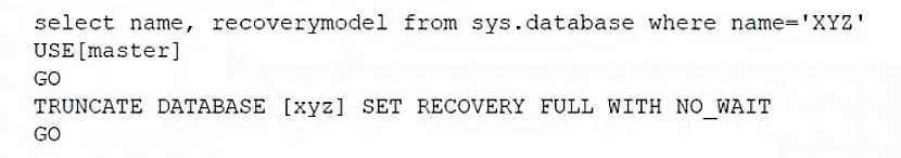

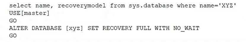

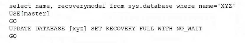

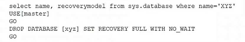

Which of the following scripts would set the database recovery model for sys.database?
The script that would set the database recovery model for sys.database is option A. This script uses
the ALTER DATABASE statement to modify the recovery model of the sys.database to full with no
wait. The other options either have syntax errors, use incorrect keywords, or do not specify the
recovery model correctly. Reference:

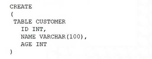

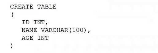

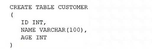

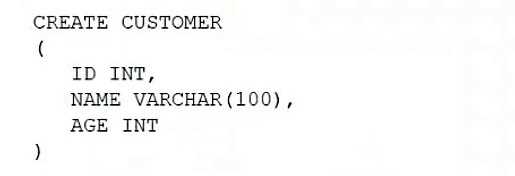

A database administrator is creating a table, which will contain customer data, for an online business.
Which of the following SQL syntaxes should the administrator use to create an object?
The SQL syntax that the administrator should use to create an object is option B. This syntax uses
the CREATE
TABLE statement
to
define
new
table
named customer with
four
columns: customer_id, name, email, and phone. Each column has a data type and a constraint, such
as NOT NULL or PRIMARY KEY. The other options either have syntax errors, use incorrect keywords,
or do not specify the table name or columns correctly. Reference:

A database administrator would like to create a table named XYZ. Which of the following queries
should the database administrator use to create the table?
The query that the administrator should use to create the table is option B. This query uses
the CREATE TABLE statement to define a new table named XYZ with three columns: ID, Name,
and Age. Each column has a data type and a constraint, such as NOT NULL, PRIMARY KEY, or CHECK.
The other options either have syntax errors, use incorrect keywords, or do not specify the table name
CompTIA DataSys+ Course Outline
, Domain 1.0 Database
Fundamentals, Objective 1.1 Given a scenario, identify and apply database structure types.
