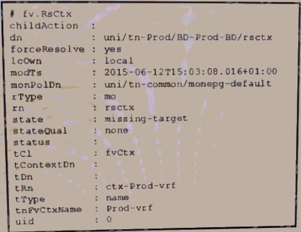

Refer to the exhibit
The configured bridge domain with name "Prod-BD" m tenant Prod is not functioning property Which option describes a
possible reason for that failure?
  • A. The context "Prod-vrf" does not exist m the fabric.
  • B. The "missing-target" state field indicates that there are not leaves with endpoint in the bridge domain, so it is not configured anywhere.
  • C. Someone has deleted the monitoring object "monepg default".
  • D. The tenant "Prod" has been deleted.

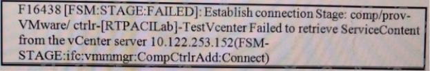

Which option is a potential reason why you would see this output while provisioning a DVS?
  • A. The specified data center does not exist on the vCenter m question.
  • B. The Cisco APIC(s) cannot reach the vCenter host/vm.
  • C. The Service Content process has crashed.
  • D. Cisco Discovery Protocol is disabled on the vswitch policy tied to the corresponding AAEP.
