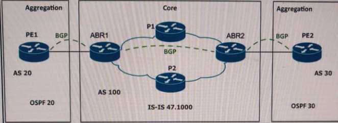

Refer to the exhibit. Which two actions must be applied to provide a seamless MPLS solution that
integrates aggregation and core of the areas of the network by providing scalable end-to-end LSPs?
(Choose two)
  • A. Enable VRF lite between core and aggregation links
  • B. Extend the IS-IS domain used in the core to the aggregation areas of the network
  • C. Deploy BGP between PEs and ASBRs with RFC 3107
  • D. Set the next hop for the prefixes advertised by the ABR
  • E. Replace Layer 3 VPN services with Layer 2 VPN services

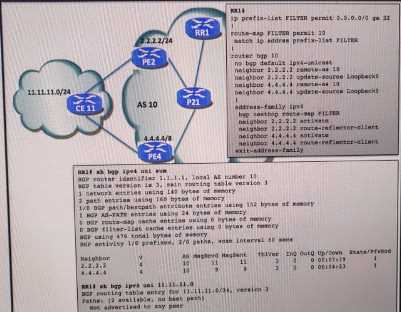

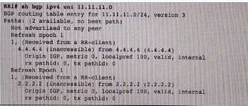

Refer to the exhibit. Router RR1 is not able to select a best path for prefix 11.11.11.0/24. What is the
root cause of this issue?
  • A. The RR1 routing table has no specific route to reach the BGP next hops
  • B. BGP Next-Hop Tracking feature is disabled on R02 and R04
  • C. R02 and R04 neighbors negotiated via BGP capability a BGP Prefix-based Outbound Route Filtering, which filters 11.11.11.0/24 prefix
  • D. Selective BGP next-Hop Route Filtering is enabled, which marks the BGP next hop as unreachable

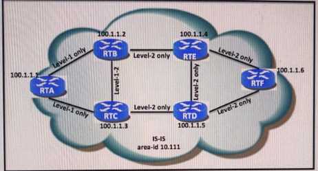

Refer to the exhibit. There is reachability among all routers. An MPLS TE auto-tunnel mesh is
deployed in all routers. A full mesh auto-tunnel is created successfully among RTB, RTC, RTE, RTD,
and RTF routers. RTA router is able to build an automatic MPLS TE tunnel that has only RTB and RTC
routers as destinations. Why is the RTA router unable to build an automatic MPLS TE tunnel that has
RTE, RTD, or RTF routers as destinations?
  • A. IS-IS does not support auto-tunnel mesh groups, only OSPF does, via opaque LSA
  • B. Tunnel affinity is not supported for full mesh auto-tunnels
  • C. An explicit path identifies the L1L2 routers among RTC, RTE, RTP, and RTF is required
  • D. Auto-tunnel mesh groups do not support interarea tunnels

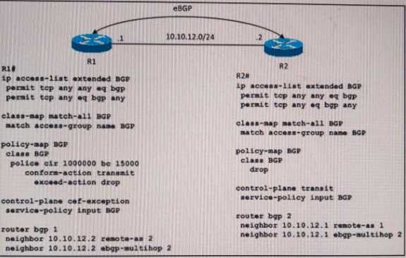

Refer to the exhibit. Which description of the BGP status between these two routers is true?
  • A. The EBGP status is down due to the CoPP applied on R1.
  • B. The EBGP status is oscillating between down and established due to the CoPP applied on R2
  • C. The EBGP status is down due to the CoPP applied on R2
  • D. The EBGP status is established because the CPPr applied on both routers does not affect the BGP peering

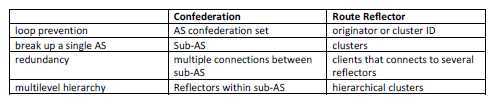

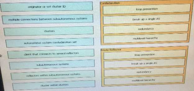

Drag and drop the BGP AS configuration or route-reflector characteristic from the left onto the
correct scalability topic on the right

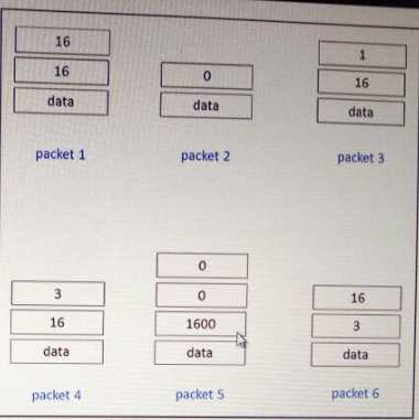

Refer to the exhibit. Which two label stacks must never be seen on the wire? (Choose two)
  • A. Packet 6
  • B. Packet 1
  • C. Packet 3
  • D. Packet 2
  • E. Packet 4
  • F. Packet 5
A, F
