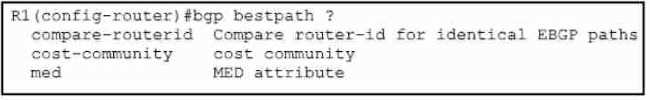

When entering a question mark after bgp bestpath only three options are visible. Which two options
are valid BGP hidden options for the bgp bestpath command? (Choose two.)
  • A. bgp bestpath as-path multipath relax
  • B. bgp bestpath as-path ignore
  • C. bgp bestpath compare-all
  • D. bgp bestpalh localpref Ignore

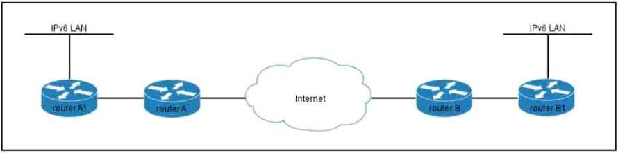

Routers A and B are the edge devices at two different sites as shown. If each site contains an IPv6
network that must be able to communicate over an IPsec tunnel, which type of authentication can
be in use between the two sites?
  • A. MD5
  • B. pre-shared key
  • C. 802.1X
  • D. CHAP

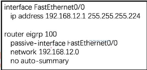

What are two effects of the given configuration? (Choose two.)
  • A. The router will fail to form neighbor adjacencies over all EIGRP interfaces except F0/0
  • B. The router will fail to form neighbor adjacencies over interfaces F0/0
  • C. The router will manually summarize the 192.168.12.0127 network
  • D. The router will install the 192.168.12.0/27 network into its EIGRP topology table
  • E. Auto-summarization will be enabled to the FO/O interface
