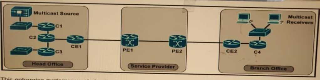

The enterprise customer wants to stream one-way video from their head office to eight branch
offices using multicast. Their current service provider provides a Layer3 VPN solution and manages
the CE routers, but they do not currently support multicast. Which solution quickly allows this
multicast traffic to go through while allowing for future scalability?
  • A. Enable a GRE tunnel between nodes CE1 and CE2
  • B. Enable a GRE tunnel between nodes C2 and C4
  • C. Enable a GRE tunnel between nodes C1 and C4
  • D. Implement hub and spoke MPLS VPN over DMVPN (also known as 2547o DMVPN) between CE1 and CE2
  • E. The service provider must provide a Draft Rosen solution to enable a GRE tunnel between nodes PE1 and PE2

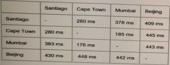

ACME Mining has four data centers in Santiago. Cape Town. Mumbai, and Beijing, full-mesh
connected via a 400 Mb/s EVP-LAN They want to deploy a new mission-critical application with these
requirements:
cluster heartbeat 2 Mb/s continuous (250 KB/s)
cluster heartbeat one-way maximum latency 100 ms
These are the current ping tests results between the four data centers:
Which hosting data center pair can host the new application?
  • A. Mumbai and Beijing
  • B. Santiago and Cape Town
  • C. Santiago and Mumbai
  • D. Cape Town and Mumbai
  • E. Cape Town and Beijing
  • F. Santiago and Beijing

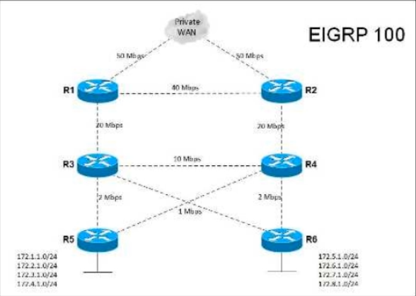

How can EIGRP topologies be designed to converge as fast as possible in the event of a point-to-
point link failure?
  • A. Limit the query domain by use of distribute lists.
  • B. Build neighbor adjacencies in a triangulated fashion.
  • C. Build neighbor adjacencies in squared fashion.
  • D. Limit the query domain by use of summarization.
  • E. Limit the query domain by use of default routes.

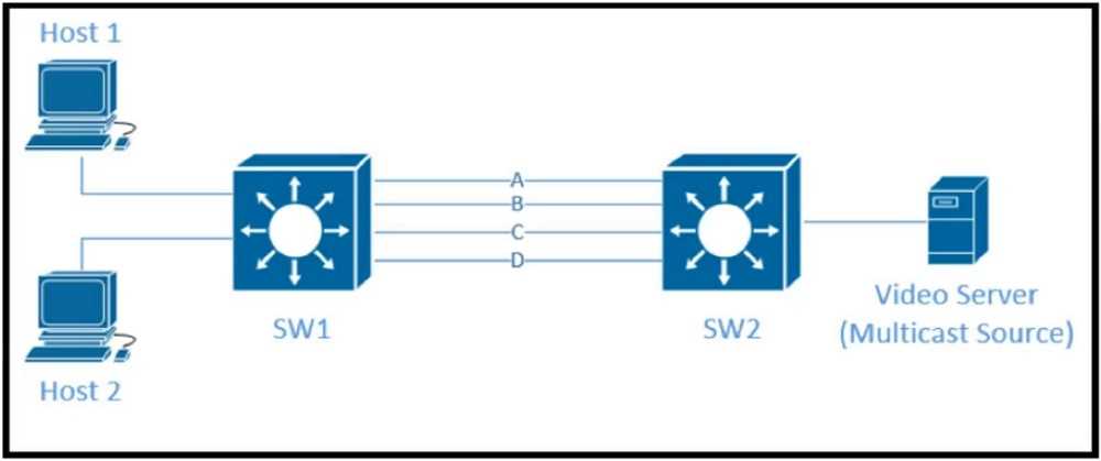

Traffic was equally balanced between Layer 3 links on core switches SW1 and SW2 before an
introduction of the new video server in the network. This video server uses multicast to send video
streams to hosts and now one of the links between core switches is over utilized Which design
solution solves this issue?
  • A. Add more links between core switches.
  • B. Aggregate links Layer 2 link aggregation.
  • C. Apply a more granular load- balancing method on SW1.
  • D. Apply a more granular load-balancing method on SW2.
  • E. Filter IGMP joins on an over -utilized link.
