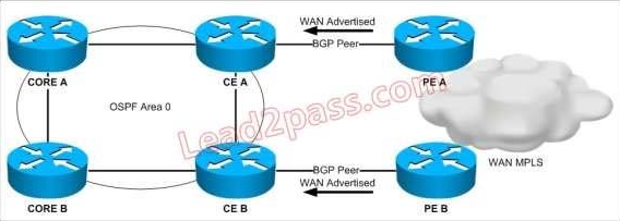

Refer to the exhibit. The design is being proposed for use within the network. The CE devices are
OSPF graceful restart-capable, and the core devices are OSPF graceful restart-aware. The WAN advertisements received from BGP are redistributed into OSPF.
A forwarding supervisor failure event takes place on CE A. During this event, how will the routes learned from the WAN be seen on the core devices?
  • A. via CE A and CE B
  • B. via CE A
  • C. via CE B
  • D. no WAN routes will be accessible

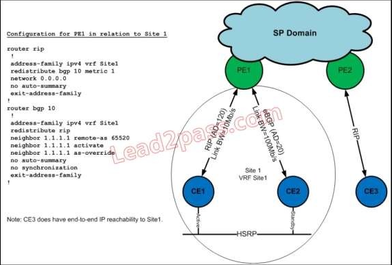

Refer to the exhibit. Your junior design engineer presents this configuration design. What is the next-hop router for CE3, and why?
  • A. CE1. BGP weight is higher than CE2.
  • B. CE2. EBGP administrative distance is lower than RIP.
  • C. CE2. The link between CE2 and PE1 has more bandwidth than CE1-to-PE1.
  • D. CE1. HSRP on CE1 is in active state.

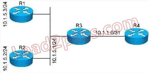

Refer to the exhibit. All routers in this network are configured to place all interfaces in OSPF area 5. R3 is the designated router on the 10.1.5.0/24 network. If you examine the OSPF database on R4, what would the network (type 2) LSA, generated by R3, contain?
  • A. a connection to 10.1.5.0/24 and links to R3, R2, and R1
  • B. a connection to 10.1.5.0/24 and links to R2 and R1
  • C. connections to 10.1.5.0/24 and 10.1.1.0/31
  • D. no connections, R3 does not generate a network (type 2) LSA in this network
