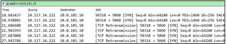

Refer to the exhibit. An administrator is attempting to register a SIP phone to a Cisco UCM but the
registration is failing. The IP address of the SIP Phone is 10.117.34.222 and the IP address of the Cisco
UCM is 10.0.101.10. Pings from the SIP phone to the Cisco UCM are successful. What is the cause of
this issue and how should it be resolved?
  • A. An NTP mismatch is preventing the connection of the TCP session between the SIP phone and the Cisco UCM. The SIP phone and Cisco UCM must be set with identical NTP sources.
  • B. The certificates on the SIP phone are not trusted by the Cisco UCM. The SIP phone must generate new certificates.
  • C. DNS lookup for the Cisco UCM FQDN is failing. The SIP phone must be reconfigured with the proper DNS server.
  • D. An network device is blocking TCP port 5060 from the SIP phone to the Cisco UCM. This device must be reconfigured to allow traffic from the IP phone. http://www.justcerts.com P-

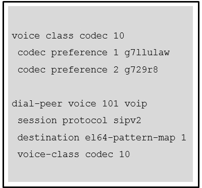

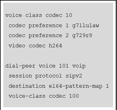

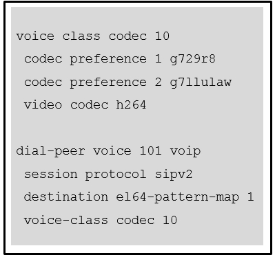

Refer to the exhibit. An engineer configures a VoIP dial peer on a Cisco gateway. Which codec is
used?
  • A. G711alaw
  • B. No codec is used (missing codec command)
  • C. G.711ulaw
  • D. G729r8

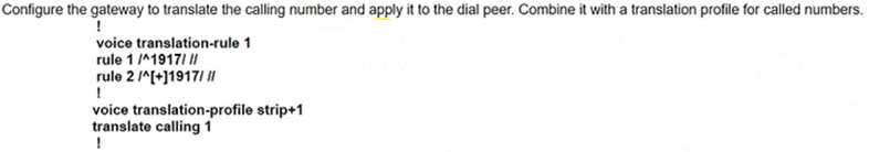

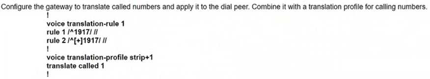

When a call Is delivered to a gateway, the calling and called party number must be adapted to the
PSTN service requirements of the trunk group. If a call is destined locally, the + sign and the explicit
country code must be replaced with a national prefix. For the same city or region, the local area code
must be replaced by a local prefix as applicable. Assuming that a Cisco UCM has a SIP trunk to a New
York gateway (area code 917). which two combinations of solutions localize the calling and called
party for a New York phone user? (Choose two.)
P-
E.

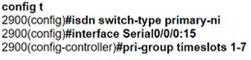

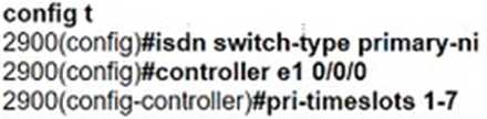

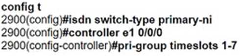

An administrator needs to create a partial PRI consisting of the first seven timeslots available. Which
configuration snippet configures the ISDN E1 PRI for this task?

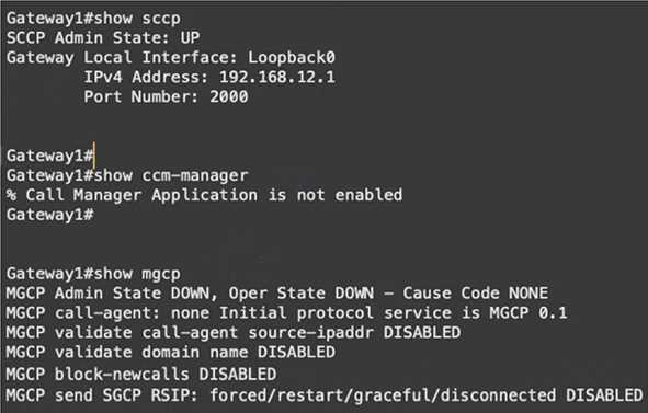

Refer to exhibit.
Refer to the exhibit. A collaboration engineer adds an analog gateway to a Cisco UCM cluster. The
engineer chooses MGCP over SCCP as the gateway protocol. Which two actions ensure that the
gateway registers? (Choose two.)
  • A. Enter "no seep" on the gateway in configuration mode.
  • B. Enter "ccm-manager mgcp" on the gateway in configuration mode.
  • C. Enter "mgcp" on the gateway in configuration mode.
  • D. Enter "ccm-manager config" on the gateway in configuration mode.
  • E. Delete and re-add the gateway configuration in Cisco UCM.
