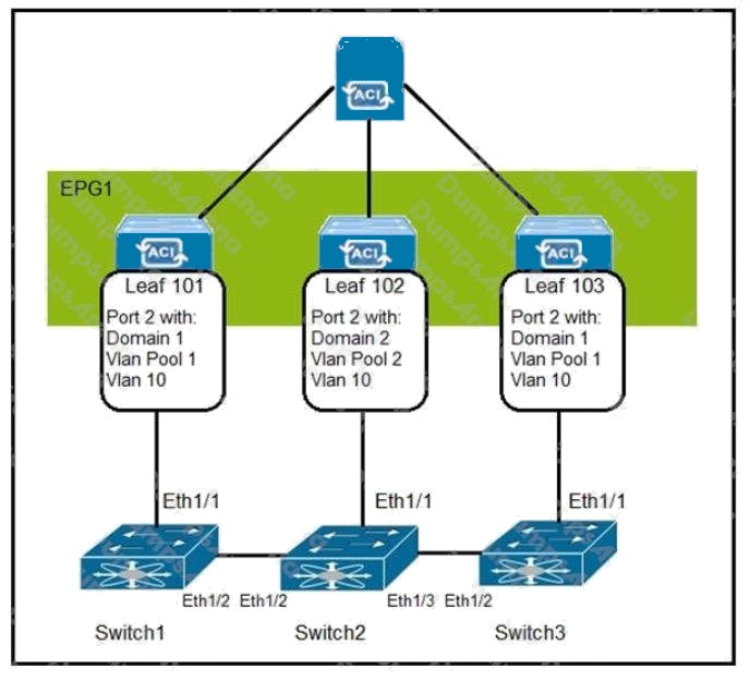

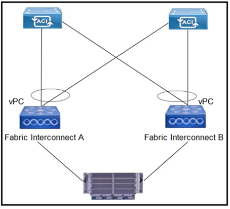

Refer to the exhibit. Which configuration mode must be selected for the VMM vSwitch Port Channel policy to avoid MAC flapping on the Cisco UCS Fls and Cisco
ACI leaf switches?
  • A. LACP Passive
  • B. MAC Pinning
  • C. LACP Active
  • D. Static Channel " Mode On

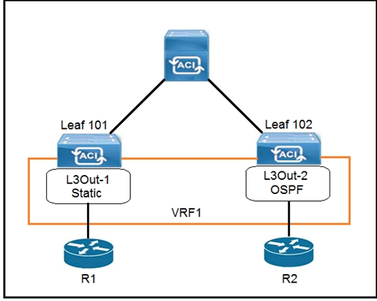

Refer to the exhibit. The 0.0.0.0/0 is configured as a default static route on L3Out-1. Which action should be taken for the 0.0.0.0/0 prefix to advertise out on
L3Out-2 OSPF?
  • A. Enable Shared Security Import Subnet
  • B. Enable Aggregate Export Subnet
  • C. Enable Shared Route Control Subnet
  • D. Enable Export Route Control Subnet

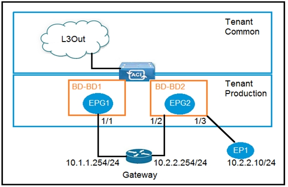

Refer to the exhibit. An engineer wants to avoid connectivity problems for the endpoint EP1 when it reaches an external L3Out network through the gateway
10.2.2.254/24. Which two configurations must be implemented in BD-BD2? (Choose two.)
  • A. Disable unicast routing
  • B. Enable IP data plane learning for the VRF
  • C. Disable ARP flooding
  • D. Enable ARP flooding
  • E. Enable unicast routing

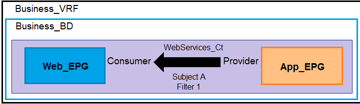

Refer to the exhibit. Which configuration set must be applied to filter 1 to enable SSH communication between Web_EPG to App_EPG?
  • A. Apply Both Directions: Disabled -Reverse Filter Ports: Enabled
  • B. Apply Both Directions: Enabled -Reverse Filter Ports: Enabled
  • C. Apply Both Directions: Disabled -Reverse Filter Ports: Disabled
  • D. Apply Both Directions: Enabled -Reverse Filter Ports: Disabled
