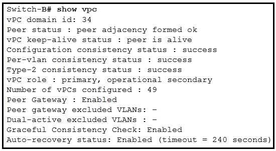

After a failover occurs, which two actions must be performed on Switch-B to manually preempt the
operational primary role back to Switch-A? (Choose two.)
  • A. Configure the local vPC role priority to have a lower value than Switch-A.
  • B. Configure the local vPC role priority to have a higher value than Switch-A.
  • C. Disable and then re-enable the vPC peer-keepalive link.
  • D. Configure the local vPC role priority to have the same value as Switch-A.
  • E. Disable and then re-enable the vPC peer link.
B, E

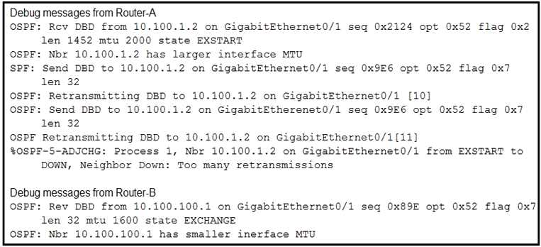

An OSPF adjacency between Router-A and Router-B cannot reach the FULL state. Which action
resolves the issue?
  • A. Adjust the MTU on Router-A to 1600.
  • B. Disable the check of the MTU value.
  • C. Set the OSPF media type to point-to-point.
  • D. Adjust the MTU on Router-B to 1604.

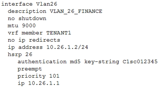

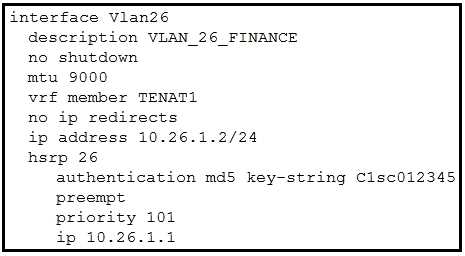

The HSRP configuration in the exhibit fails to function. Which action resolves this issue?
  • A. Enable IP redirects.
  • B. Set the MTU to 1500 bytes.
  • C. Configure HSRP version 2.
  • D. Configure the same HSRP group on both devices.

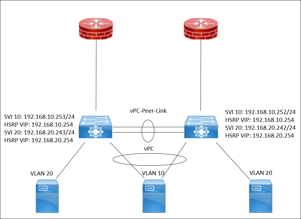

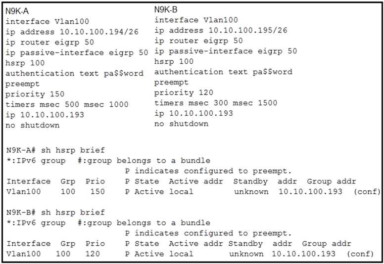

The HSRP instance on both switches is showing as active. Which action resolves the issue?
  • A. Configure the HSRP timers to be the same.
  • B. Allow VLAN 100 between the switches.
  • C. Configure the IP address of N9K-B on the same subnet as N9K-A.
  • D. Configure preempt on only one of the switches.

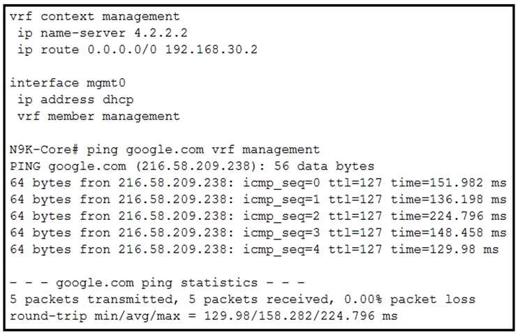

A network engineer has connected the Nexus switch management port to the Internet using DHCP to
allow the Guest shell running on the switch to download Python packages. The engineer can ping
google.com successfully from the Nexus switch, but the Guest shell failed to download any Python
packages. Which action resolves the problem?
  • A. Update the Python packages on the Cisco Nexus switch directly.
  • B. Manually configure DNS in the Guest shell, even if it is claimed on the Cisco Nexus switch through DHCP.
  • C. Manually configure NTP in the Guest shell.
  • D. Connect Guest shell to data plane interfaces to be able to connect to the networks outside the Cisco Nexus switch.

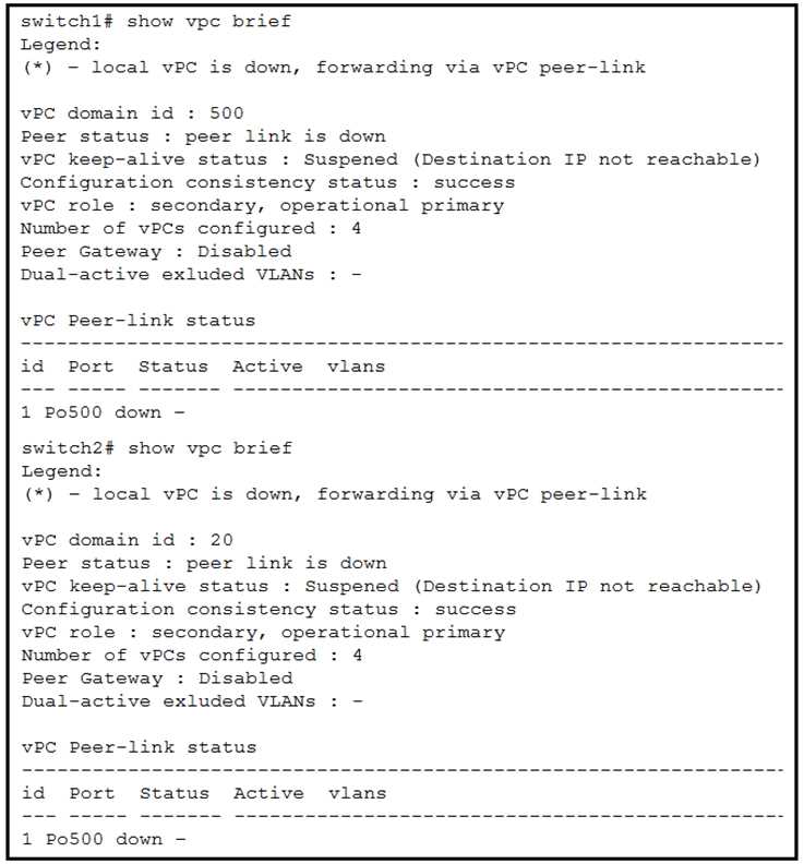

vPC between switch1 and switch2 is not working. Which two actions are needed to fix the problem?
  • A. Match vPC domain ID between the two devices.
  • B. Configure IP address on the interface.
  • C. Activate VLANs on the vPC.
  • D. Configure vPC peer link and vPC peer keepalive correctly.
  • E. Configure one of the switches as primary for the vPC.
AC

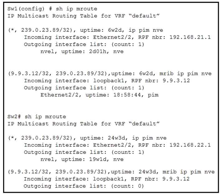

Sw1 and Sw2 are two Cisco Nexus 9000 Series Switches that run Cisco NX-OS. They are VTEPs in the
same vPC domain. Which statement describes what happens in this scenario?
  • A. Sw1 drops all traffic because there is no (S, G) OIF list to encapsulate VXLAN multicast packets and send them out to the underlay network through the uplink interfaces.
  • B. Sw1 performs the VxLAN multicast encapsulation and decapsulation for all traffic associated with the VxLAN VNIs.
  • C. Sw1 and switch 2 perform the VxLAN multicast encapsulation and decapsulation for all traffic associated with the VxLAN VNIs, depending on the hashing.
  • D. Sw2 did not send an IP PIM register to the rendezvous point for the multicast group of the VXLAN VNI.

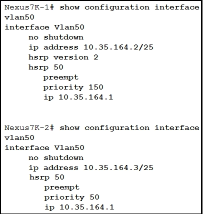

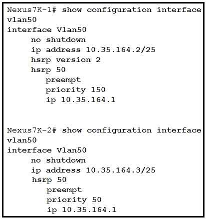

HSRP adjacency fails to form between Nexus7K-1 and Nexus7K-2. Which action should be taken to
solve the problem?
  • A. Configure preempt on one of the switches in the HSRP group.
  • B. Configure the same HSRP priority between the two switches.
  • C. Configure the correct subnet mask on Nexus7K-1.
  • D. Configure HSRP version 2 on Nexus7K-2.
