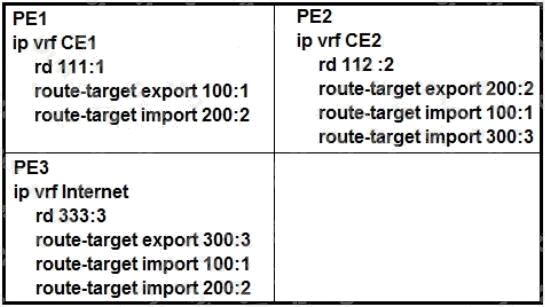

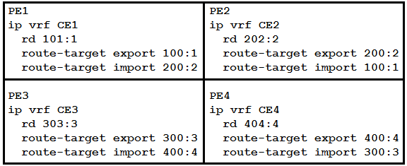

A network engineer has been called to configure the four PE devices in order to enable full
communication among the four CE devices connected to them. While starting to configure, he
experienced a connectivity issue. Which two tasks should the engineer perform in order to begin the
process correctly? (Choose two.)
  • A. Configure PE3 to export route-targets 100:1 and 200:2.
  • B. Configure PE3 to import route-targets 100:1 and 200:2.
  • C. Configure PE4 to import route-targets 101:1 and 202:2.
  • D. Configure PE2 to export route-targets 300:3 and 400:4.
  • E. Configure PE1 to import route-targets 300:3 and 400:4.

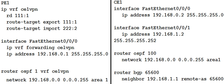

If the two devices are operating normally, which two conclusions can you draw from this
configuration? (Choose two.)
  • A. CE1 must use OSPF to establish a neighbor relationship with PE1.
  • B. PE1 labels the routes it learns from CE1 with the route-target 222:2 and shares them with its VPNv4 peers.
  • C. PE1 labels the routes it learns from CE1 with the route-target 111:1 and shares them with its VPNv4 peers.
  • D. The PE-CE routes between the devices are being exchanged by OSPF
  • E. CE1 is supporting CSC.

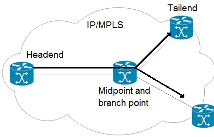

An engineer is implementing an MPLS P2MP TE solution. Which type of router can serve as the
midpoint router and the tailend router in this P2MP TE network implementation?
  • A. headend
  • B. source
  • C. transit
  • D. bud
https://www.cisco.com/c/en/us/td/docs/routers/asr920/configuration/guide/mpls/mp-te-path-setup-xe-3s-asr920-book/mp-te-path-setup-xe-3s-asr920-book_chapter_01.html

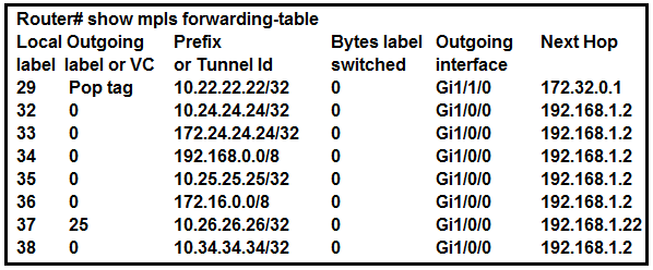

Which statement about this output is true?
  • A. The router IP 192.168.1.2 sent an implicit null, and the output is from the penultimate LSR.
  • B. The adjacent router is the egress LSR and has mpls ldp explicit-null configured.
  • C. The adjacent LSR router configured mpls label range 0.
  • D. The zero in the second column is the normal behavior of an egress router LSR.

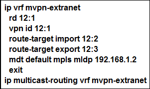

An ISP provides a major client MPLS VPN for managed services. The MPLS engineering team needs to
use the advanced VPN feature of selective VRF import so that only specific prefixes are present in the
required VPNs.
Which aspect of this feature must the team consider?
  • A. A route must pass the import route map first and then the route target import filter.
  • B. The routers that are imported in the VRF can be BGP and IGP routes, so other match conditions in the route map, besides communities, can be used.
  • C. The import-map command is applied under the PE interface that connects to the CE router.
  • D. A route is imported into the VRF only when at least one RT that is attached to the route matches one RT that is configured in the VRF and the route is permitted by the import route map.
https://www.ccexpert.us/mpls/configuring-selective-vrf-import.html
