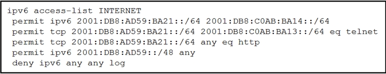

Refer to the exhibit. While monitoring VTY access to a router, an engineer notices that the router does not have any filter and anyone can access the router with username and password even though an ACL is configured.
Which command resolves this issue?
  • A. access-class INTERNET in
  • B. ip access-group INTERNET in
  • C. ipv6 traffic-filter INTERNET in
  • D. ipv6 access-class INTERNET in

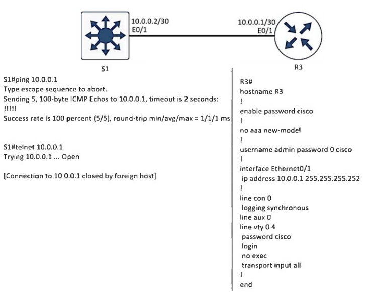

Refer to the exhibit. A network engineer cannot remote access R3 using Telnet from switch S1. Which action resolves the issue?
  • A. Allow to use the ssh -| admin 10.0.0.1 command on the switch.
  • B. Add the login admin command on the switch.
  • C. Add the transport input telnet command on R3.
  • D. Allow the inbound connection via the exec command on R3.

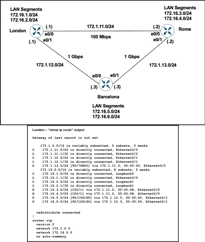

Refer to the exhibits. London must reach Rome using a faster path via EIGRP if all the links are up, but it failed to take this path. Which action resolves the issue?
  • A. Change the administrative distance of RIP to 150.
  • B. Increase the bandwidth of the link between London and Barcelona.
  • C. Use the network statement on London to inject the 172.16.X.0/24 networks into EIGRP.
  • D. Use the network statement on Rome to inject the 172.16.X.0/24 networks into EIGRP.

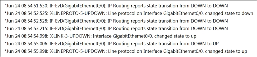

Refer to the exhibit. R1 is connected with R2 via GigabitEthernet0/0, and R2 cannot ping R1.
What action will fix the issue?
  • A. Fix route dampening configured on the router.
  • B. Replace the SFP module because it is not supported.
  • C. Fix IP Event Dampening configured on the interface.
  • D. Correct the IP SLA probe that failed.
