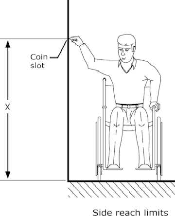

Exhibit:
A pay telephone using coins needs to be installed in a public are
a. In the specifications, it is required that the telephone shall meet the ADA (Americans with
Disability Act) requirement for side reach using a wheelchair. What will be the maximum reachable
height or the value of "X"?
  • A. 760 mm (30 in)
  • B. 864 mm (34 in)
  • C. 1170 mm (46 in)
  • D. 1220 mm (48 in)
  • E. 1370 mm (54 in)

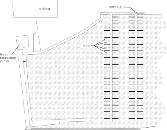

Exhibit:
In this future marina layout, what would be the pre-cabling guideline to follow for the terminal A?
  • A. Place distribution cable onto the dock and terminate in a suitable cabinet or enclosure. Run service drop to each boat slip.
  • B. Provide one or two pair cables from the boat slips to a distribution terminal on the closest point of land.
  • C. Pre-cable each boat slip during construction.
  • D. For security, each run should be terminated in the patch panel/ cross-connect at the dockmaster or marina office.

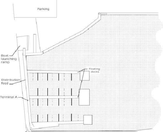

Exhibit:
In this future marina layout, assuming that there are fewer than 10 slips being cabled, what would be
the pre-cabling guideline to follow for terminal A?
  • A. Installed one or two pair cables from the boat slips to a distribution terminal on the closest point of land.
  • B. Place distribution cable onto the dock and terminate in a suitable cabinet or enclosure. Install service drop to each boat slip.
  • D. For security, each install should be terminated in the patch panel/cross-connect at the dockmaster or marina office.

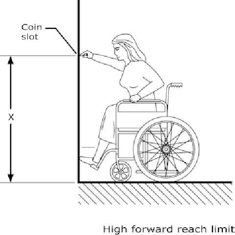

Exhibit:
a. In the specifications, it is required that the telephone shall meet the ADA (American with
Disabilities Act) requirement for front reach using a wheelchair. What will be the maximum
reachable height or the value of "X"?
  • A. 760 mm (30 in)
  • B. 864 mm (34 in)
