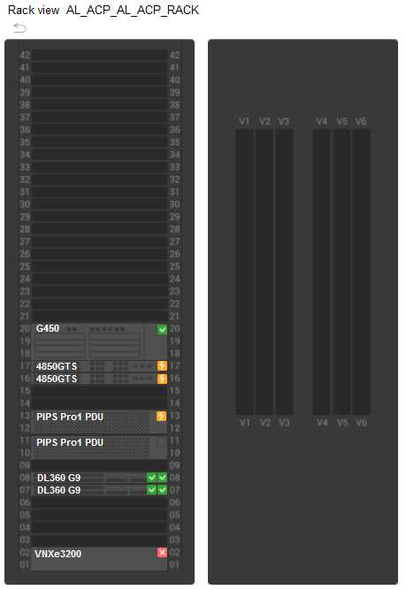

To get a visualization of the hardware components, and their positions in the ACP 4200 rack, which
management application can an engineer use?
  • A. MSC
  • B. Orchestrator
  • C. vCenter Client in Flash mode
  • D. vCenter Client in HTML5 mode:
https://downloads.avaya.com/css/P8/documents/101054946
