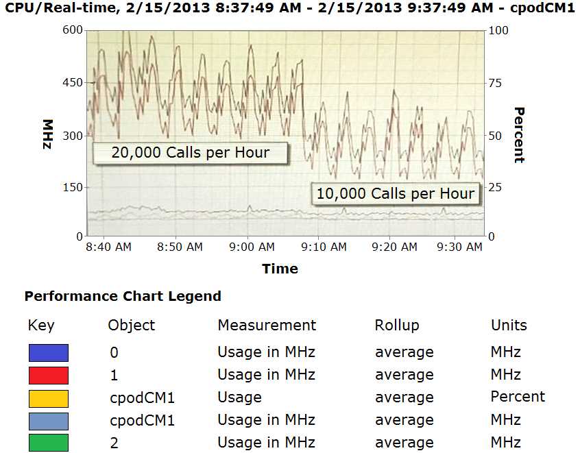

The CPU performance of Communication Manager (CM) shows a significant difference depending on
the call rates.
Which statement about making configuration changes is true?
  • A. Increasing the number of Virtual CPUs allocated to CM might help to reduce this difference.
  • B. Ensuring that a secondary CM is available to allow for load-balancing might help to reduce this difference.
  • C. Migrating the CM Virtual Machine to another ESXi host that is less busy might help to reduce this difference.
  • D. Reducing this difference is not necessary because this is expected behavior.

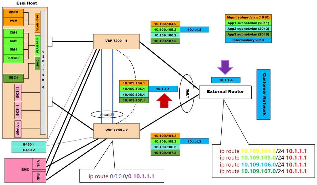

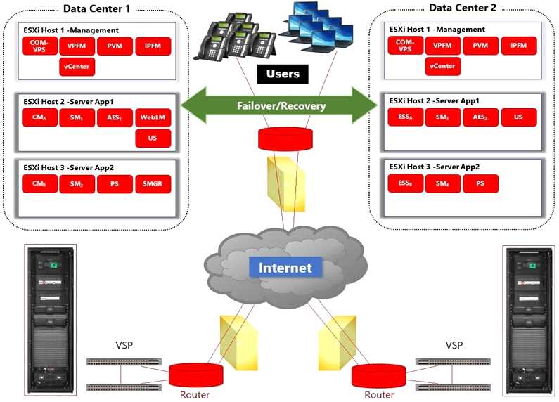

In the deployment shown in the exhibit, how is High Availability achieved across the two Data
Centers?
  • A. By ensuring that the L2 VLANs are extended across to both Data Centers.
  • B. By managing both Data Centers using the same vCenter Server and using vMotion and DRS.
  • C. By using Virtualization Provisioning Service (VPS) to automate the provisioning of the network hardware and vSwitches across the two Data Centers.
  • D. By using Avaya Aura® Application High Availability features.

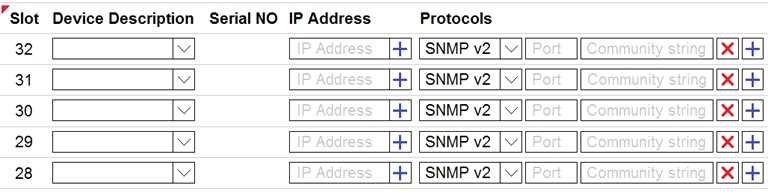

An administrator is adding new equipment to the ACP 4200 in the Avaya Orchestrator Configuration
Wizard.
How do the IP Address and Protocols fields get populated?
  • A. These are optional fields that do not need to be populated.
  • B. These are automatically detected by clicking on the Detect Hardware button.
  • C. These are manually entered by the administrator.
  • D. These are imported from the ACP Configurator Tool Excel spreadsheet.

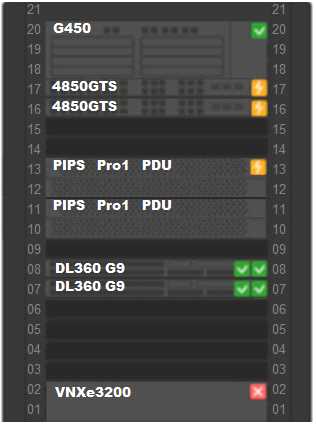

An administrator navigates to the Avaya Orchestrator page shown in the exhibit. The 4850GTS
switches and the PIPS Pro1 PDUs are displaying an Orange status icon.
What does this indicate?
  • A. These devices have not been configured with correct credentials.
  • B. These devices have power supply issues.
  • C. These devices have services with status of warning.
  • D. These devices have reachability issues.

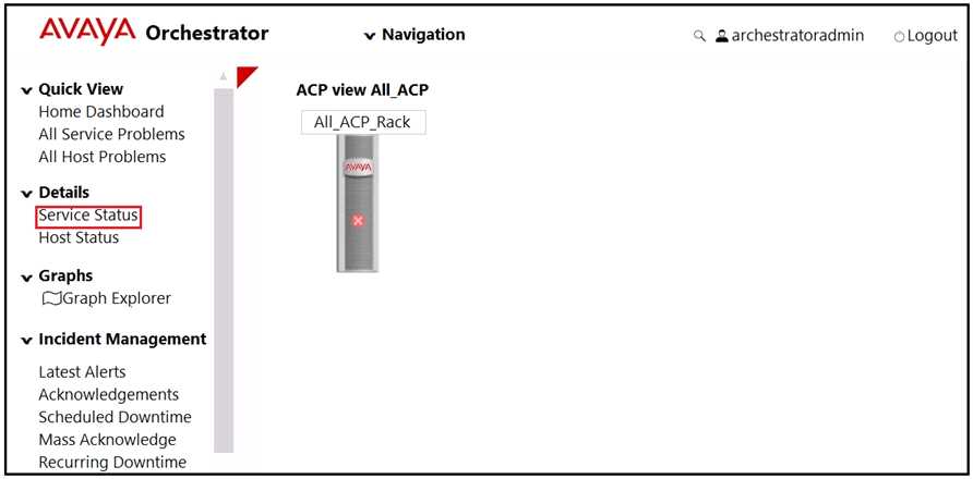

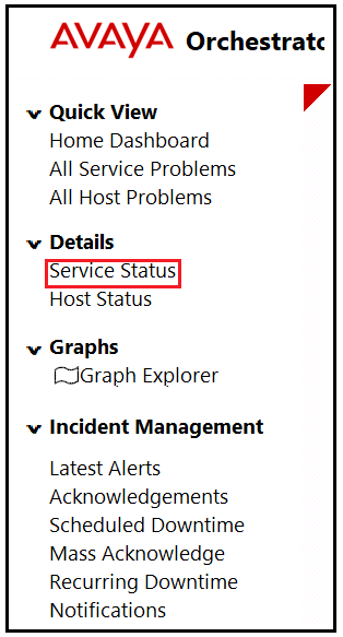

An administrator navigates to the Avaya Orchestrator link shown in the exhibit. What would the
Administrator be able to monitor here?
  • A. A list of Services with status of Warning or Critical.
  • B. A list of Services with status of OK.
  • C. A list of Services regardless of status.
  • D. A list of Services which have additional details.

An administrator notices that the Rack View of Avaya Orchestrator is highlighted with a Red X on the
graphical representation of the rack.
  • A. At least 50% of the hosts in the rack contain a service which is in critical state.
  • B. The rack has a front door that is currently unlocked.
  • C. The rack is currently unreachable.
  • D. At least one of the hosts in the rack contains a service which is in critical state.
